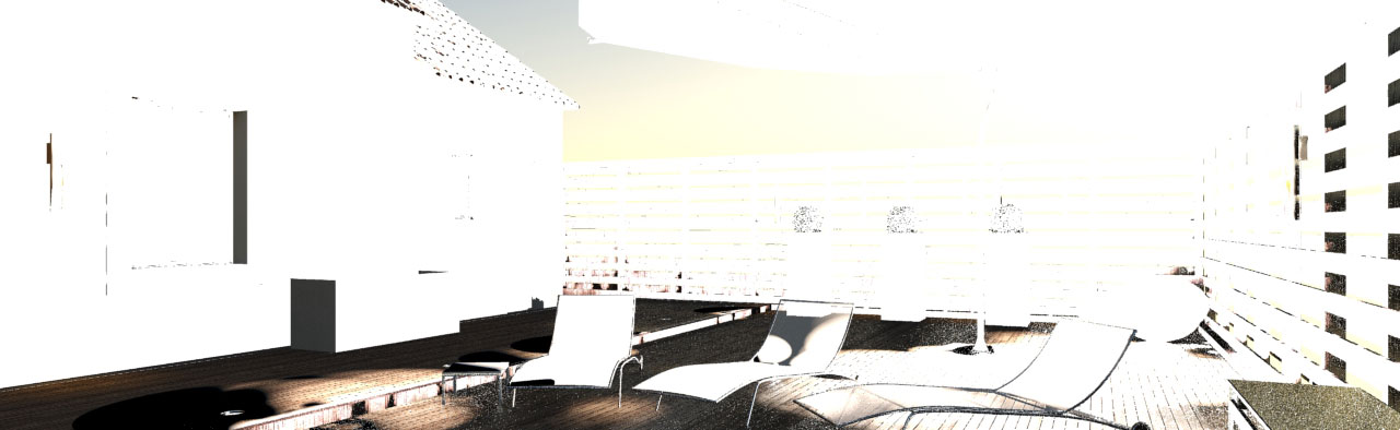

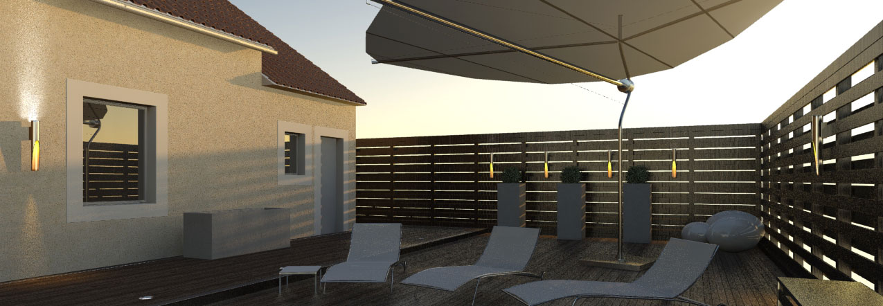

I'm meeting an issue whe using luminous surface with Physical Sky: here's a picture with only Physical Sky and some photometric lights:

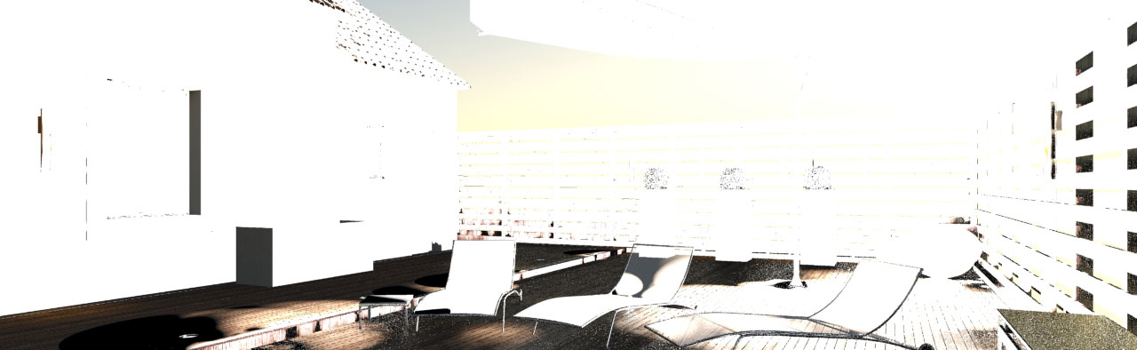

What I want is to light the tree balloons lights with a luminous surface (the tree balls at the back right of the picture), but here's the result when adding 1% luminosity to their surface: (1% luminosity on the surface is the only change I've made)
The Kray options setup are all the "low" preset without any changes, maybe there is an issue with photometric light?

Can you show last tab from Kray (Quality Tab)...maybe you have direct mode ON?

Hi Johnny! Thank you for quick answer. Problem came from here indeed :D
My luminosity model was indirect (the one by default?) and switching to the other mode (automatic and direct) allow kray to render the surface correctly (well it crash one time, but after crash everything fine, even with indirect)
I'm gonna check the manual on that area in order to understand how it's working, but thank you again!
Re: Physical Sky and Lumi surfaces
Looks like a bad photon bug in indirect mode... If you can simplify scene and send it to me I will add it to our bugtracker.
