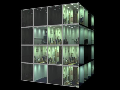

I'm testing kray and vRoom v1.2
lightwave v 9.31 and default setting on kray
kray v1.7 it works well (a bit slow.. but completed )

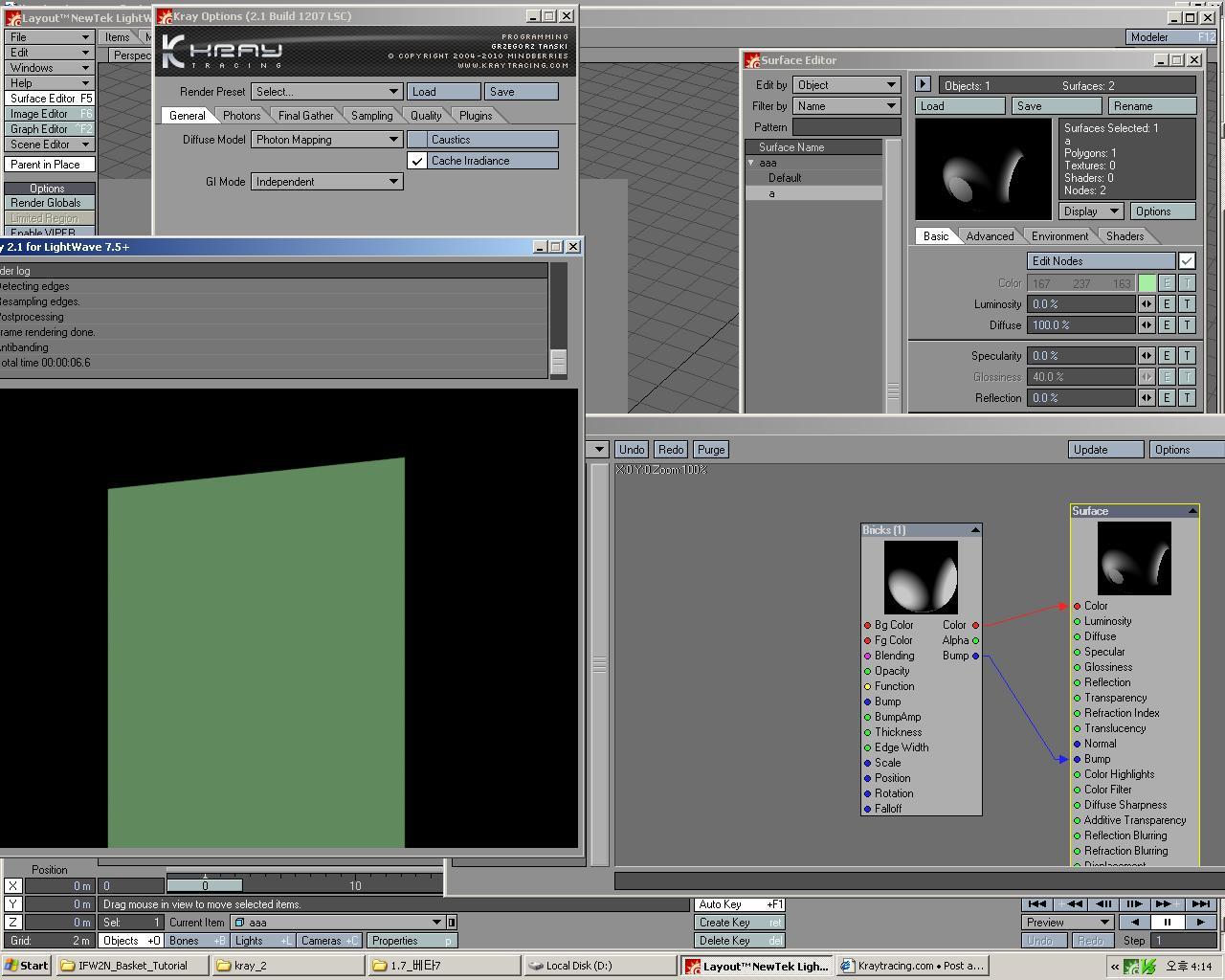

kray v2.1 it does not work ( can't recognize at all , the result is same as screen shot I've cliped on this post)
v2.1 may be advanced version and taking into account that kraytracing is working on node compatibility ,
it is somewhat weird .
vroom is one of the most important plug in for construction CG
eurisko say they support kray....

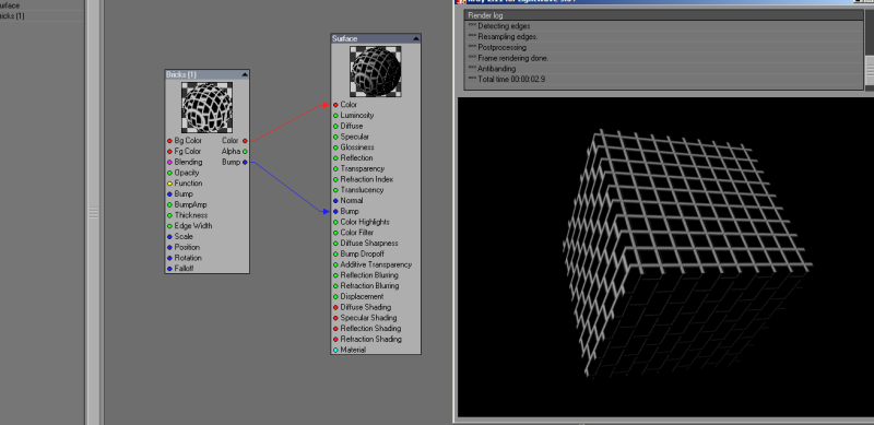

and additional problem happened ! it does not support lw built-in node , just brick3D .
is there should be some adjustment for node compatibility ?
I cliped brick render fail screen shot .. every raytrace option on... no other texture but brick procedural node .
kray v1.7 work even though it is "material node(vRoom)"
but v 2.1 does not work even just a texture node under the same circumstances
so I assume vRoom compatibility problem is caused by kray for some reason

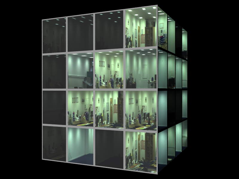

Hmm, nope, VRoom works as expected here - see image.
However, Jure... it is HORRIBLY slow. The "computing global PM" part takes ages to complete - the attached image rendered in about 14 minutes with K-ray while it took only about 40 seconds with LW native. I really need some optimization advice here - I'm also attaching the kray settings I've used, if you'd be so kind as to take a look at those...

Okay so Luke (the vRoom guy) was nice enough to let me test vRoom with Kray. It seems to work fine here except that photons take very long time to shoot like you mentioned. Try using "Emit" mode in photons panel - it should be much faster.

Yeah, Luke's a great fellow. And it worked! Down to 3 minutes now - perfectly acceptable. The final images looks exactly the same, so um... what did I just do? Is there any particular reason, or set of circumstances, why I should prefer one method to the other?jure wrote:Okay so Luke (the vRoom guy) was nice enough to let me test vRoom with Kray. It seems to work fine here except that photons take very long time to shoot like you mentioned. Try using "Emit" mode in photons panel - it should be much faster.
