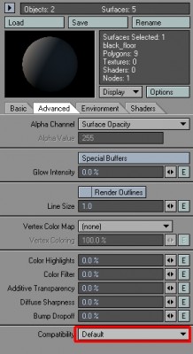

I didnt understand what were you referring to when talking about compatibility option in the surface panel...
Also, do you recommend using lumi polys instead of area lights?
Cheers
				Re: WIP_First Kray render
				Posted: Thu Mar 18, 2010 10:47 am
				by jure
				inakito wrote:Hi Jure,
Cheers
This is the setting I was talking about:
-  Compatibility setting
Yes, in general lumi polys seem to work better than area lights.
