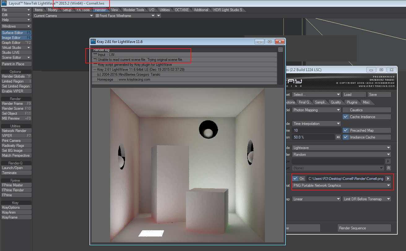

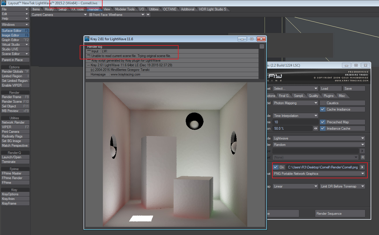

I tested v2.61 with Cornell scene and the problems are still there.
Bake GI loop and "Unable to read current scene".
Tested locally in 2015.2 Lw version

The scene is the Cornell file that you have provided, the only thing I change was render saving path and the "Unable to read current scene" appears.
To test the bakeGi I removed the balls from Cornell scene and made a 100 frames camera animation. The loop appears.
The looping problem is the most serious for me.
Cornell_BakeGI.lws
(55.48 KiB) Downloaded 1210 times
Cornell.lws
(68.4 KiB) Downloaded 1220 times
sotto3d.com

Thanks for info!
Apparently problem appear randomly here :roll:
When I save lws with correct procedures after that everything is ok.
That situation has only one solution: I have to catch this problem with G. being on-line. Sorry for problems, I will try catch G. as soon possible (likely these errors are not so much bad and we can live with them ...apparently I bit longer then I was thinking :wink: ).

ideart wrote:Yes interpolation setting was in the original scene 10 but in the scene I send you I missed adding the zero at the end, I tend to forget often that part, sorry about that and thank you for noticing. Also additional advises from you are always more than welcome.
The scene is rendering flicker free, but it would be nice to have the bake GI option as a additional choice. Thank you for sending the loop issue to G.
ps. I attach a screenshot of the error message
hey guys. this problem it come from lw. once u export ur whole scn in package u wil lget this i remeber . u need to check button reload orignal scn after exporting . or the obj you use like box and spher in layout so when u edit the odel and u send obj to layout again u will get it .
good luck.

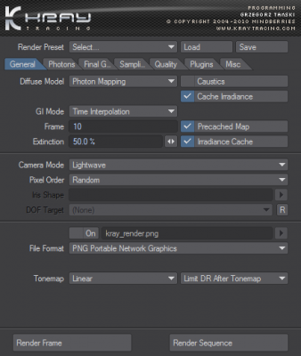

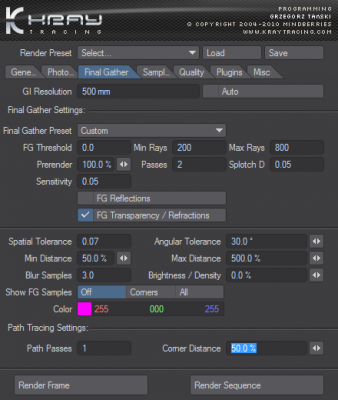

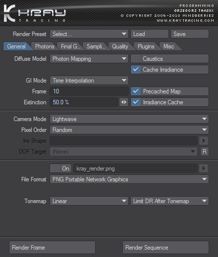

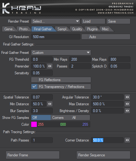

Re: Animation
Here setting:
Remember Random Pixel Order (is very important to get better GI) and also I think in your animation you had very low quality sampling.
It must be 2 passes, more FG blur:
In fact by this setting above you will lose nice contact shadow but this is no so much important in animation.
