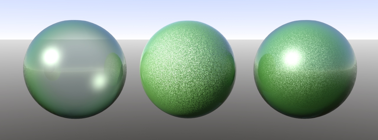

I spend last night on making a car metallic shader. Here is the result: (first clearcoat, then flakes, then result combined)
So here's a small overview of what I did:
1. Lightwave lighting: since lightwave does not render the lights in the reflection but only a simpel impression in the specular channel, I used specular on the clearcoat. Kray does make area light vissible in the render but neither of both render engines does it for spotlight. Aka the sun is not visible in a render on for example metallic surfaces. You can use the physical sky or sunsky to fix this. But I decided to clone my light and set one to specular and other to diffuse. The diffuse light I set to area light, specular light to spotlight.
So my conclusion is that you need to use specular on high reflective materials for outside scenes. (This is why for example Arnold is good for outside scenes, because its mainly a specular render engine)
2. For some reason I cant make a LM or layered material. I need to work on this. Maybe Janusz can help me a bit with it. So I made 2 models: 1 for the clearcoat (scaled 101%) and 1 for the base paint with flakes. This is how we use to do it back in the old days, we used to make SSS and stuff with this setup. If I can make the LM material then this is solved.
3. Render times are at 2 minutes. Will work on this, but its okay allready.
4. The clear coat is simple glass material with some darkening for the Fresnel. But I used specular to simulate the reflection of the sun.
5. Flake layer is half bump/normals. Other half is setup with cook terrance. This is a shader model driven by specular. I only use it to place the bright flakes where the specular from the sun is.
So now I will sleep a bit and maybe later I will tweak a bit and share the result.
TO NEWTEK: please make spotlights visible in render, this is something thats been an issue for too long. I understand thats its easy to use specular - but it should be in the reflection channel of the render. And how difficult is it to make a working carpaint material, even Unity has a cool one...
Best and I will keep you posted!

So did not sleep, continued working on it.
So this is what you need to do:
Modeler:
1. Select body of car. Surface this as carpaint.
2. Copy body of car, set to new layer. Surface this as clearcoat AND Smooth scale it (modify > transform > more > smooth scale) Set to 3 mm. This creates the thicknes of the clearcoat layer.
Layout:
1. Copy my surface settings
2. Play with the values. Color of the clearcoat and carpaint. Etc. Some fresnels/incidenceangles needed to be done with curves. So open them and play with the values.
Surface settings: Let me know how it goes!
Best...
