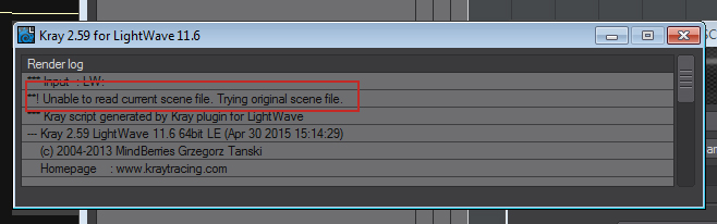

ps. I attach a screenshot of the error message

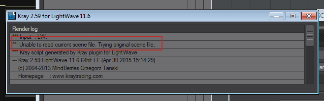

ok will ask G. what it means. I can not get this error.

I'm getting the same error when I try to render a scene loaded from a mounted network drive, but it renders fine. No problem during rendering, just the message.
Re: Animation
...maybe problem is on writing rights in system? It looks like Windows/Mac has no access to override lws file system (also by Network)...I just guess.
Second idea is that, it can be problem after saving in Lw2015.03 scene and backing with this lws to previous version LW2015.02. Some changes in LW SDK can affect problems for Kray.
The best idea is open fresh scene without Kray (no Load Items from Scene) and add Kray fresh setting from hand (no load setting). It always helped me with strange behavior in Lightwave.

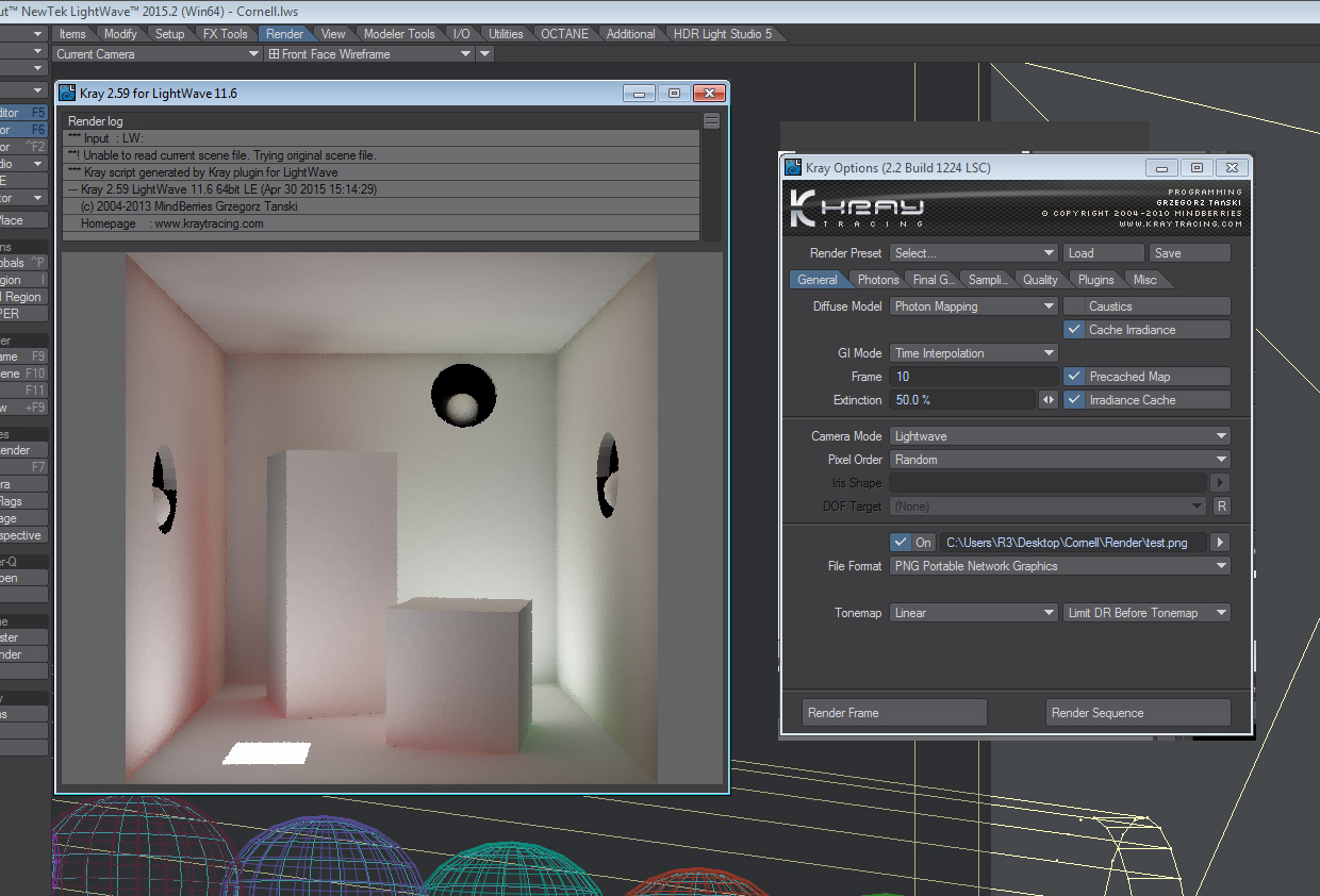

Thanks for the cornel scene.
I tested cornell scene and the exactly same problem appears.
I opened the scene and the only setting I changed was checking saving path to local folder.
Scene renders normally when press animation but not saving renders. I have to save the scene, reload it and then renders fine to my local path. This is only when I press render animation, for single frame no problem. Now imagine if I have a large scene and I have to reload it every time I change a single setting.
Ps. I tested in 3 different pc's.

Re: Animation
Yes, you can see from the render save path the local content folder I have used.Janusz Biela wrote:Did you start scene locally (no network at all)? Windows or Mac?
I use windows 7.

Ah Sorry, did not see information about path.
I got finally also this error "Unable to read..."
Send to G. right now Cornell scene.
Thank you for paying attention!
