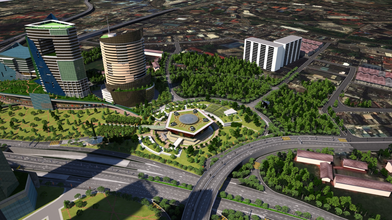

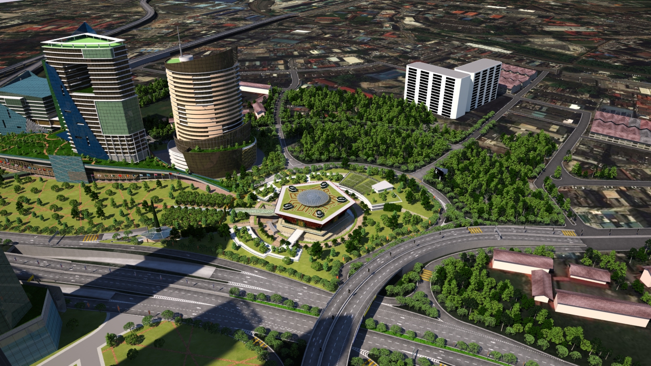

Anyway here is the latest image rendered with 720p resolution. It took more than 8 hours. This is just a test render and soon will be add a lot of vehicle animate, people walking etc. Any opinion how can I reduce the render speed? I aspect can render it 1 frame 5-9 minutes because I have almost 8000++ frame to render. Should I reduce the trees? Or the polygon of trees?
Thanks.
Azmen

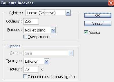

Indexed color is a color mode which reduce the amount of color of a picture, in many cases 256 color picture are enough (yes I didn't believe that at first, but it really work), here's a screenshot of the Photoshop windows (in French sorry):
I guess that "original file" means evermotion trees? They render nice...but my god, so much polys...maybe let you surprise by low poly models...It should will be few hours of works to win hundred hours of rendering?
