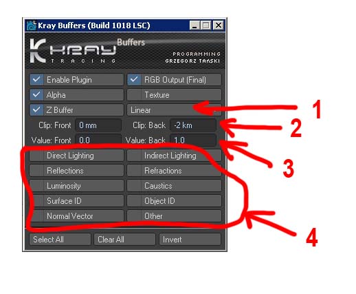

I didn't select the 'File Format PNG/TGA/TIFF + Alpha' on general tab because the button 'ON' (upper 'file format list') is off. Also if I'm not mistaken that some one was told me that if I want to use a native LW image saver turn it off. So, should I turn ON and choose the Fle Format for that?
Anyway I just tried to save used z-buffers in Kray but after done the rendering it can't read in AE & Photoshop.
Also I need some detail and what exactly function in Kray Buffers, if you don't mind. :)

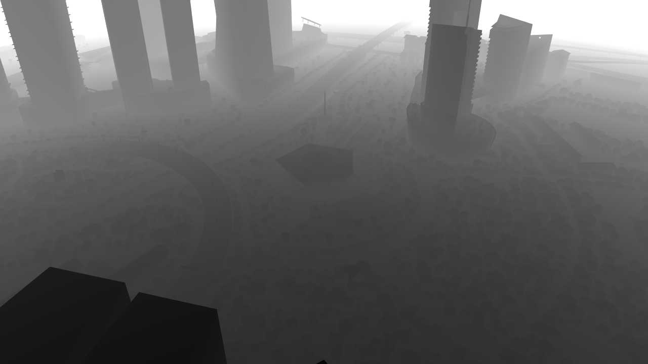

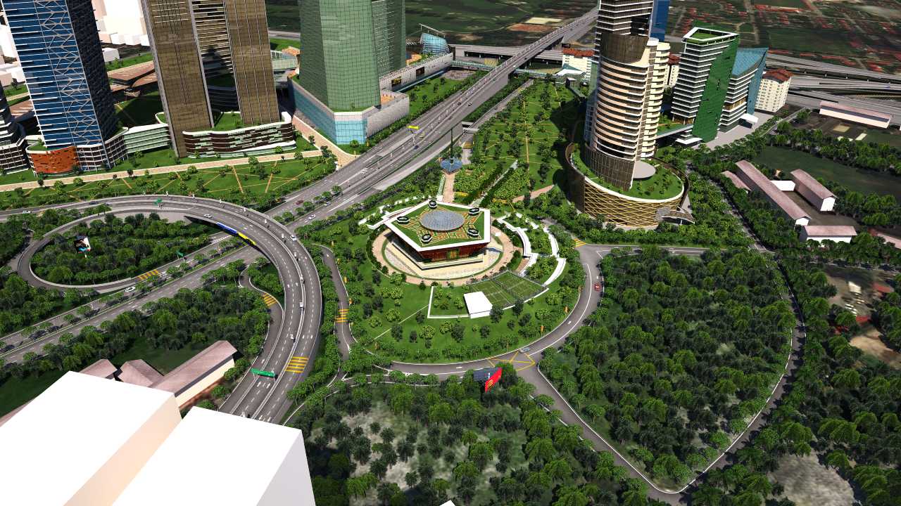

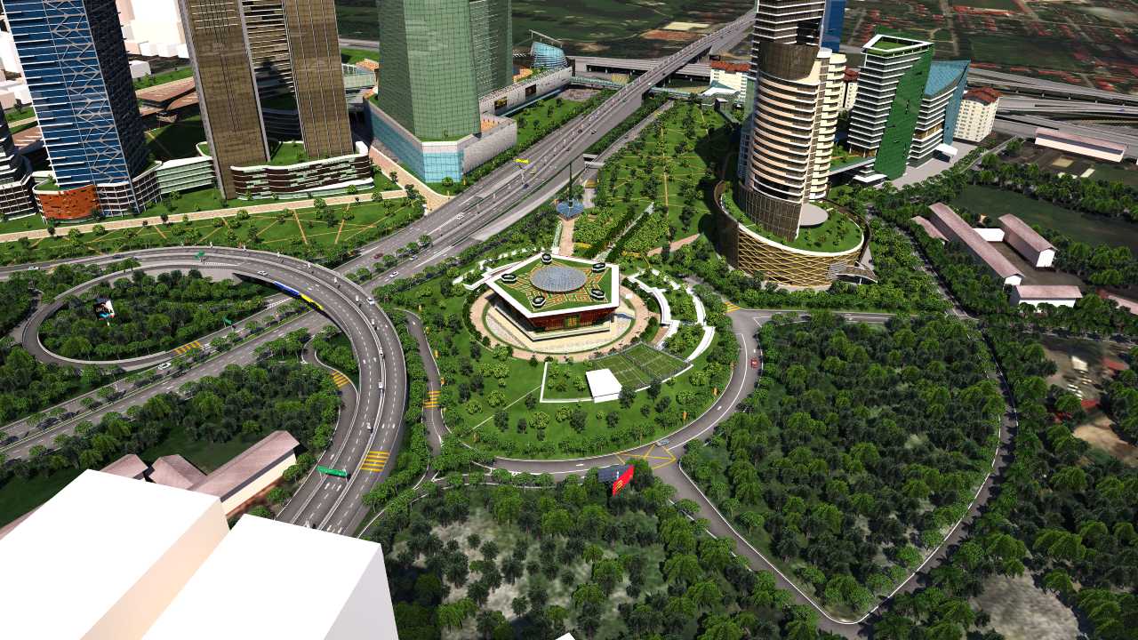

Jure, I've problem with Image Format File. Usually for animation I'll save it to TIFF but in Kray TIFF can't read but others are great.
Anyway I'm looking the tutorial how to make a DOF or Fog use Lenscare in AE with 2 images (RGB + z-buffer)
RGB - JPEG (Original was TGA + Alpha)
Z-Buffer - JPEG
Render time - 6 minutes ++, HD 720p
Also I need to know the function what is the meaning for black & white area.
Re: RPF & Kray.
Really good render :)
Btw jpg as Z-buffer is quite not good idea (matrix compression destroy important blends in image)

Oh, Actually the original format was TARGA files (both). For this 1 I convert to JPEG so it won't be a huge file. :)
Usually I use a TIFF for the animation abut I've problem that I can't open it on AE & Photoshop.
Need some detail explanation about black + white (clip front & back + value front & back). :)

Re: RPF & Kray.
azman_821009 wrote: Oh, Actually the original format was TARGA files (both). For this 1 I convert to JPEG so it won't be a huge file. :)
Use PNG output.. it's best...
Re: RPF & Kray.
I think for this camera (last render ) front and back clip should be different: around 500m/2000m....you don`t need effects fog near camera

Janusz Biela wrote:I think for this camera (last render ) front and back clip should be different: around 500m/2000m....you don`t need effects fog near camera
This is my setting for Buffer.
Anyway, how can I setup the DoF at front and behind the focus object? For example like that image, the nearest object (white block) and behind (tower) have a DoF. I'm still explore how to setup with clip and value.
