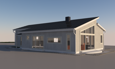

				Here´s the scene I have been fighting with for a while now... I would be a lot happier if someone with more skills than me could take a look at it and see if there´s any salvation for it!

				after downloading I miss some copstone100 object, it is instanced in your scene a lot.
the LWS is set on raytrace and it renders fast here.
In what way does it behave totally insane? The render looks similar to what LW and FPrime make of it.
I got some of your errors fixed after looking further, you added all kray plugins as master plugin and unchecked them. It looks like the physky does not like that at all with your current setting of your sunlight. Delete all kray plugins that you unchecked.
Another thing, kray does not render the backdrop image set in compositing tab. Use a quad to get that.

				this is just a technical test of your scene, please try this LWS overthere.

				I am uploading this scene plus objects (no Images dir) to my webspace now:
http://www.xs4all.nl/~ezcc2/kray/jaxtone.zip
I saw you used luminosity and specular on surfaces, I set those to 0%.
physky does not crash here by setting turbidity from 2 to 1.5, the sky turns black though. I think this (brandnew) lscript will get some input restrictions, so use 2.0 to 8.0 for now.

				jaxtone wrote:Hi Erwin!
I looked at the scenes now and I have questions of the attached image you have named as "EZtest2.png"! Please see attached image!
I rendered out one image for each scene file you attached! Please see attached images!
the final picture I showed was ofcourse the v004.lws scene. I guess you did not overwrite your own faulty objects with my corrected ones, in your render of my scene 04, your surfaces still give light.
Also, when I load that scene back the exposure of physical sky is the same as when I saved it. If that does not happens overthere, your install must be incorrect.
I noticed in your screenshot, the Kray Tonemap Blending master plugin is gone and you have Lscript Commander in there. How did that get there?
Did you install the .lsc files of the supplied kray RC5 zip? Did you delete all old .ls files in the plugin directories that LW autoscans every time it starts?
About your question inside the picture (btw I prefer stuff typed in post to be able to quote and comment on it in my reply), I just picked a time of physical sky and I did like it. I disabled your sun, because it was placed just above the horizon. I also did delete your fake fill light. The comment of the overbright material is simple, I did not change your material settings, that is your job
 Your original scene looked horrible in LW and FPrime too.
Turn color down a bit. About reflections, add a nicer environment to reflect or else the glass never will look better.
Because I had to check your claim of the exposure on 0, I did load the scene, changed the time and rendered again, see attached v005 LWS and rendered result.
Forget about the older LWS's, they used your wrong surfacing and were just little tests to see what was wrong in your original scene.
Now it is time to work on your scene and worry less about kray.
