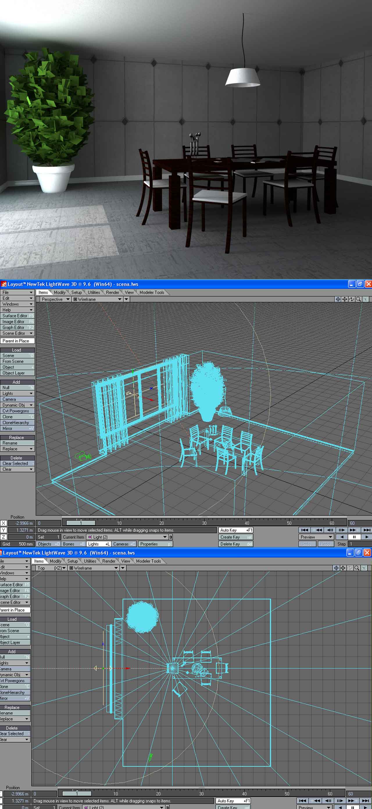

hi Leftover, today i've re see your work.
so i'he study a system to render perfect work as you but is not possible obtain it.
the render with table and chair have a setup as photographic study? there are other light source after sun and area at windows?
i think you have used a backlight system in your interior but i don't understand where are it!!!
can you help me?
can you help me?

this is the scene, but please post the result and setup so i can study itmathewlp wrote:Hello
Ok this can be interesting maybe we could help
will you share your're scene & object files plz
download it from rapidshare 10 times
http://rapidshare.com/files/226374148/t ... e.zip.html
the texture for skydome is this
http://www.kraytracing.com/new/distribu ... &mode=view
you can use your texture for other object

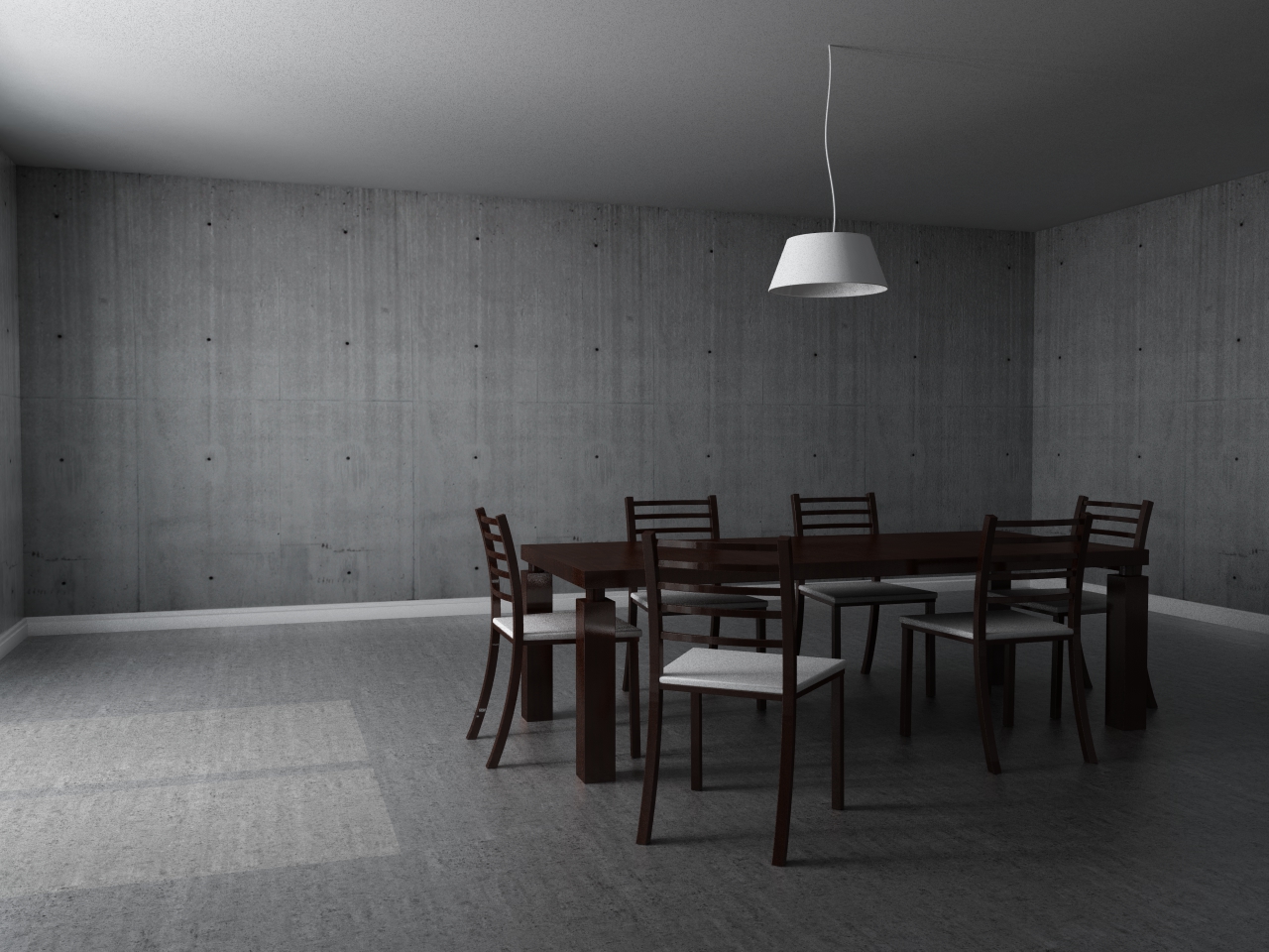

Lumi ball 100% lumi with gradient texture, Sun beige colour with POWER 5 PHOTONS 500
Area light windows POWER 5 PHOTON 500 Inv. Dist 5m, colour light blue-white
20 bounces light recurse 20 irradianceblurgamma 0.3
Exponential 2.2, 1
spatial tolerence 0.01
Desaturate Shader on the floor 50%, 1, Diffuse 75%, reflection 15%
Power in Kray setup PHOTONS TAB 0.5
AA Hight preset
NO SPECULAR
Maybe have to increse PhotonNumberMultiplier for area
I kept this dark color for wood don't know excactly the color u wanted...
No post proc in PS
Exponential 2.2, 1
AA Hight preset
NO SPECULAR
No post proc in PS

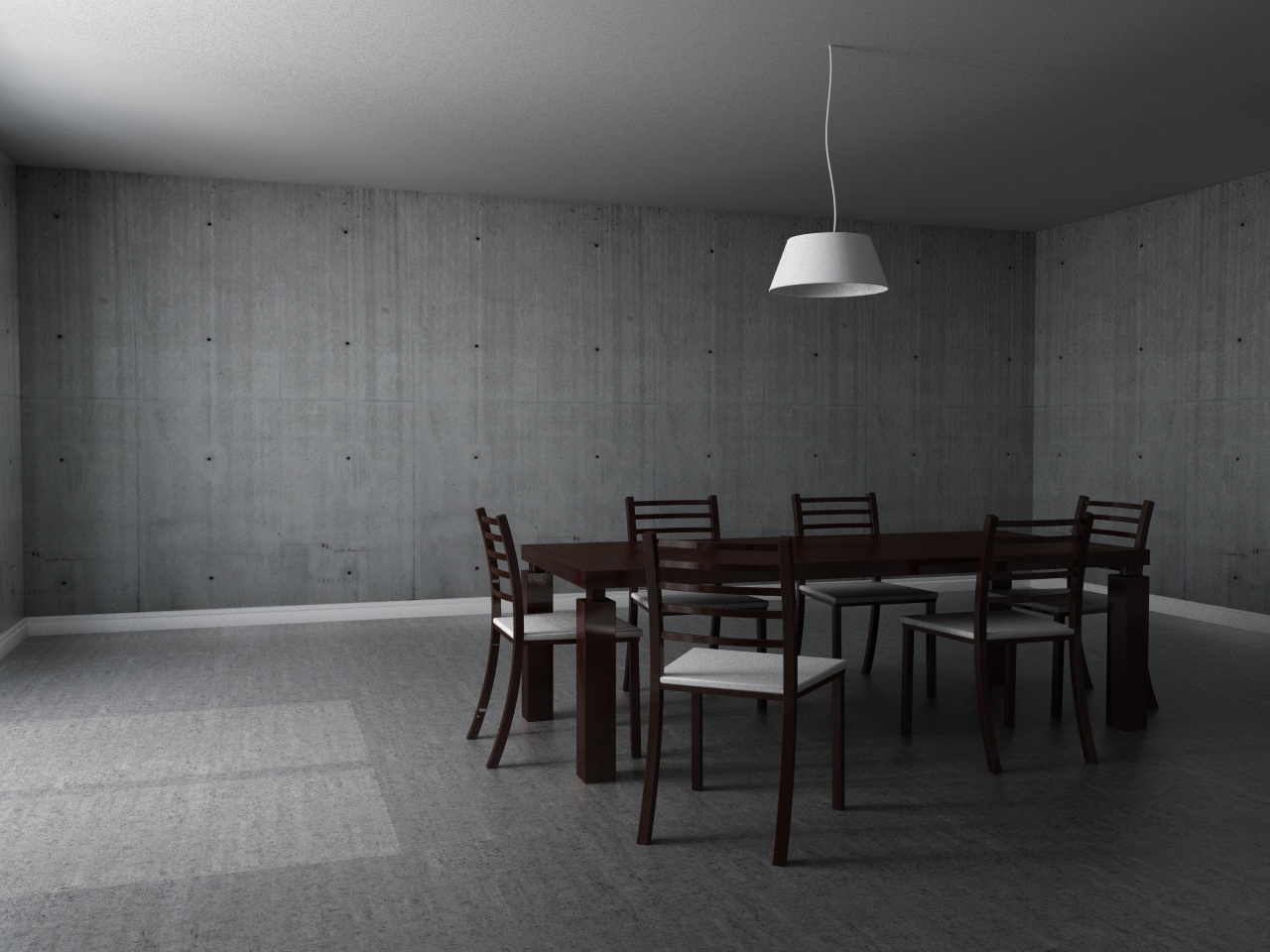

Re: coupe test renders
Hi guys
In the same scene I have a some problems... to be sincer, I have the same problem in every rendering I do with Kray...
Anyway, in this case the problem concern the floor... I did apply to the floor a parquet texture... In the final render the color of the floor affect the entire image and so I have a predominance of red/yellow (in other word, of orange). I tried to change the saturation of the texture by the "edit panel" and my render work better... but the surface of the floor lose the color intensity and now result too bright... But I need it in the original color...
what can I do?
what can I do?
