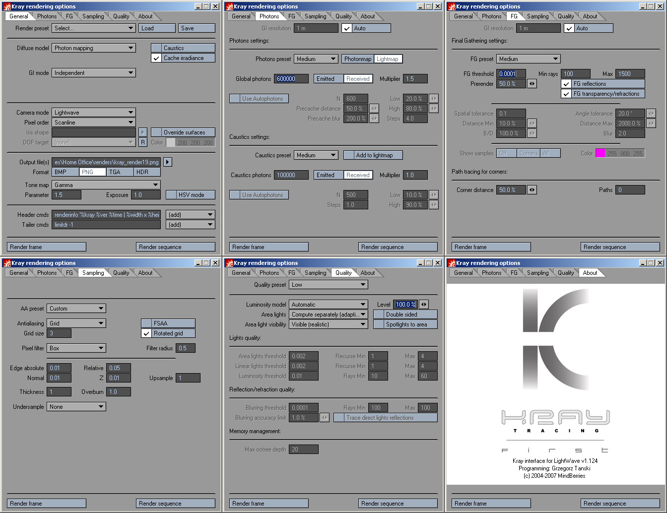

Thanks very much Pheidian, I really appreciate it. Of course, I then had to go and look at your thread of your "Personal Kitchen Practice" & see your render times... :( You're killing me... lol
I'm just starting to get more of the type of lighting I want in Kray (not there yet, but closer then when 1st started), but the render times are still nuts on a Quad Core. I know Kray is suppose to be faster, I see it your render times, so why is it taking me 1 to 3 hrs on a Quad Core for a resolution like 1920 x 2560? Would posting my settings help for feed back? Is it because I'm not using luminous polys, but a spot?

ARGH? You're using spot light to light up your scene? uh...
Yea do post your setup for Photons and FG and let's see what we can do to improve...

I know, I know...you've mentioned sky dome. I'll try it right now. :oops: On the skydome, do you go half sphere with a flat bottom? Do you still use skylight plug-in?
I've attached my settings. I really appreciate your willingness & attitude to help Pheidian. 3.5hrs to render on Kray is just insane.

No problem, here are some basic stuff for you:
Tailer Command line:
recurse 10;prerender 1,4,0.1;gradients_neighbour 0.1
first: recurse 10 is 10 bounces, (same as recursion limit in render globals in LW, this will overwrite that settings).
Prerender with this setting, will run 4 different passes for GI solution, refining the places there will need to be more samples (multisampling).
Gradients_neighbour command is used for "blurring" the neighbour cells of photonmap... I'm not sure If I get the explanations right, but this is what I understand of these :)
For Quick preview, lower the passes from 4 to 1 (crappy GI, but fast), example:
recurse 10;prerender 1,1,0.1;gradients_neighbour 0.1
You can try different, 1, 2 ,3 for this multipassing to see which suites you (maybe don't need 4 pass).
Photons tab:
don't use auto solution, put 500mm there for GI resolution. But you have to have the scene in 1:1 for real world scale (1 meter in LW is 1 meter in real world object size)
Increase photons, like 1 000 000 maybe. You can try different photon numbers to see limited region render from critical places (dark places). This is for quick preview.
FG tab:
Change to custom (so you can tweak all settings).
FG treshold to 0.0
prerender to 100%
FG min/max: try different setups, like 200 / 600 might be enough for multipassing the scene FG... (prerender tailer command) other good stuff to try is 400 / 800, 800 / 2500.
Spatial tolerance can you 0.1 or smaller (for small object detail shadows)
Angle tolerance 30
Distance min 30, max 500... I'm not quite sure what these are about, but playing around with this works well... and tweak and see :)
BD and blur to 0.
ALWAYS use indirect mode for luminosity model in Quality tab! And luminosity polygons... :)
Also memory management (make this custom so you can access all setups) Octree depth should be around 200 or 300 if you have more than 2GB memory. This is just memory handling for kray.
Hope some of these settings help you get better render and faster times :)
