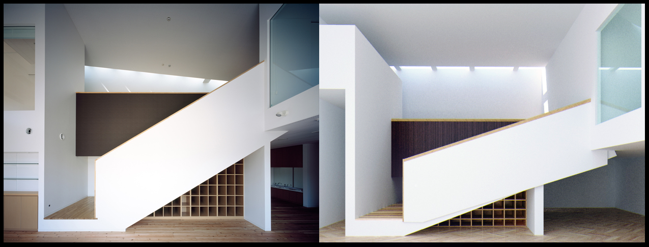

qmc grainy ?
this is default setup .
left its picture and right kray render .
u can increase number if u dont want grainy .

Yes, QMC is grainy (I can clearly see noise on your image) unless you increase values which increase the render time significantly.
The alternative is to double render size and reduce the image size. That smooths everything out.

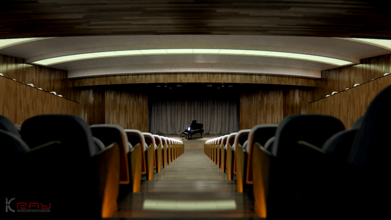

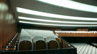

In attachment some my renders done in Path Tracing. Time renders under 20 min...impossible to achieve by Final Gathering.

See attachmentsI accept that for some scenes QMC can be faster, but personally I haven't seen many.
Auditorium has
- almost 600 Instanced chairs
- 10 Physical Lights (Area Lights)
- 170 IES Lights
- around 300 Lumi Lights (halogens)
This scene I render much faster in QMC then Final Gathering

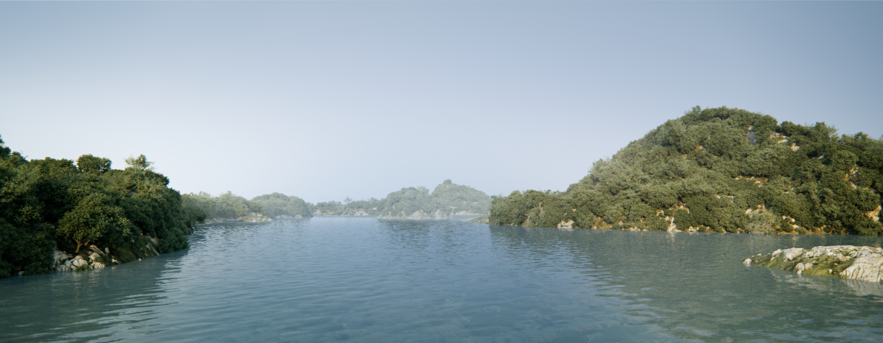

In some cases only Path Tracing can help: huge exterior scenes. Bake GI is not ultimate solution - it`s only good for small and medium scenes.jnom wrote:

Personally I do not use Bake GI in Exteriors - better is to save Photon Map in a couple of seconds and start render animation immediately in QMC then wait 1-2 days for baking GI an growing this file up to 2-4 Giga (praying it will finish without problems).

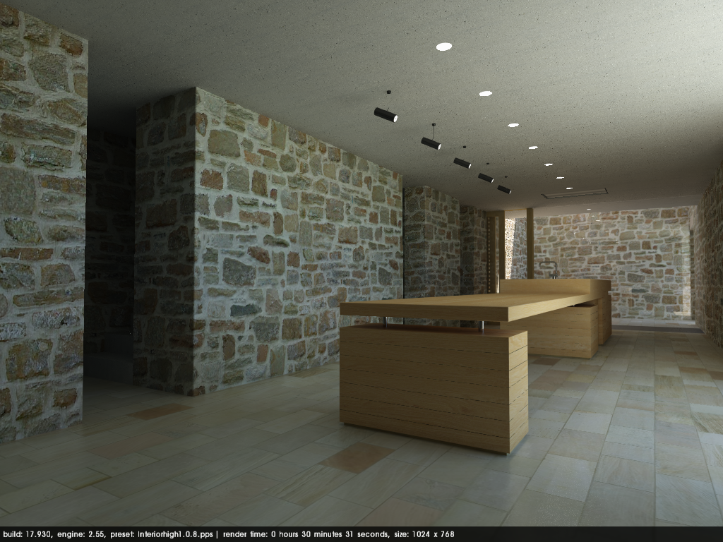

I've attached 2 identical test renders, one is with QMC, the other with PM with 2 passes. You can see that quality is probably better with PM, and render time is significantly lower. 300% time increase with QMC. I'm rendering on a Corei5 Macbook Pro. That explains render speed but not the difference.
so, probably something wrong with my QMC settings

Definitely you set up something wrong.
In Podium are different values then in Lightwav Kray - of course the core is the same.
I think:
GI Resolution 0.5 is too big (if this is in meters then should be 0.3-04)
Min/Max FG rays 5000 (here also is different value so I do not know - in Kray for this noise level should be around 200/700)
FGblur 2 - it doesn`t work in QMC mode. But for Final Gathering is too high also (In Kray maximum should be 0.5-1.0)
This Interior should render on i7 12 HT in QMC mode in 10-20 min.
In my opinion this is not good scene for testing - too less details.
If you want compare GI, always use override mode to see details (textures and dark colours cover details in corners and details in GI).
Also Precomputed/unfiltered render shows size of cells and this should be also rendered.
In render with QMC mode I see something wrong with Photon Map - looks as too high GI resolution which affect light leaks.
