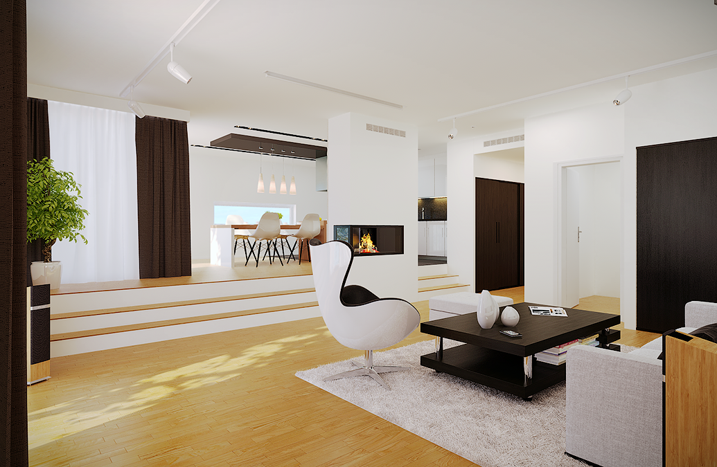

Wow that carpet is amzing!!!! :shock: :shock: :shock:

Thank You but is really hard to say, after many years renders with Kray many thinks comes easy even without thinking. I think this is just matter to know very well soft and his possibilities and also thinking how avoid problems with limits in software (for example this carpet: basic clone instance. I know Kray instance is very primitive tool but small good idea can increase effect....)
